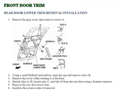

Bonjour, j'ai trouvé la page dans la doc technique pour démonter ce panneau.
Ce qu'il me manque, c'est la technique...
Comment on démonte ces clips A, B et les "locators"?
J'arrive même pas à y accéder.
Ben écoute j'ai réussi à enlever les clips A & B mais il y en a un qui a cassée en tirant dessus mais bon apres remontage RAS avec un seul clips...
Tire FORT !!!!!!!!!!!!!!!!!!

ça tombe bien faut que je remplace un panneau arrière par un autre que j'ai récupéré.
donc en gros on détache gentiment le cache poignée on dévisse et ensuite on tire comme un bourrin pour que le panneau se détache c'est ça ?
je sens que je vais tout péter .
Si c'est comme les portes avant...ouai, faut tirer
Oubliez pas les visses avant hein
Oui, c'est ça.
Le "fastener remover" c'est la force tes bras.
1) For the rear doors, there are also three screws that need to be taken out before you go ripping the panel out. They are marked in the picture below. (Don't ask why I didn't put A B and C this time) We'll start with the one by the handle that opens the door. That comes off just like the front door. Open the little round door with a small flat head screwdriver and the bezel should slide right out when you have the door handle held open. Now your "good to go". (No I don't work for Taco Bell)
2) This step is to get to the other two screws out that are hidden in the handel in the middle of the panel. To get to these look at the pics below. All you have to do is grip around the bottom of the handel with your fingers, feel the seem in the back of the handel and pull straight out. It'll come right off.
3) Now it's time to pull the panel off. For this just reach in where the seat belt retracts and pull that corner out.
4) After you pull that corner out grab that corner and the handle and pull. It'll come off in one peice and you get a bare door. Congradulate your self and ask again. Why did I just take the rear door panels off?
