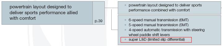

Voiçi ce qu'on trouve dans le press kit de Mazda
(dispo sur le site Mazda CH, presskit.pdf)
super limited slip differential (LSD)
The sports-dedicated LSD installed in the RX-7 had a high TBR* at 2.6 ~ 3.0 and was designed for exceptionally skilled drivers.
For the RX-8, Mazda developed a torque-sensing Super LSD to support
enjoyable and safe driving over a wider range of conditions,
from everyday maneuvering to forceful driving-at-the-limit.
Super LSD has a low TBR of 2.0, which assures predictably
smooth vehicle behaviour during fast cornering and on low friction**
road surfaces, and improves stability during off-theline
acceleration and straight-running.
Super LSD is fitted as standard on High Power specification cars, and is available as an option or
standard in different markets on Standard Power cars.
  • TBR: Torque Bias Ratio
    Characteristic that indicates the level of differential control.
    TBR is expressed as high m torque/low m torque.
