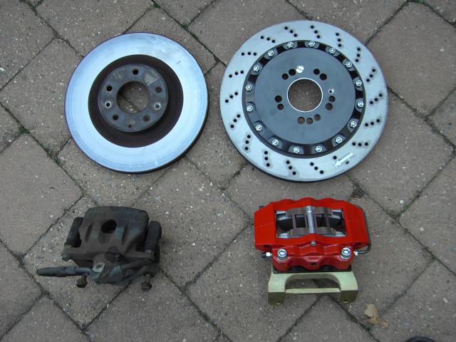

Outjer, what is really the problem with the gearing/gearbox ?
some times it's a bit rough or is it you think the gears are too long ?
Yep,
Much too long.
In 4 gear driving at 180 kmh means about 6300 revs.
That means I use only about 150/160 hp of the 192 hp.
That means the seat diesels, etc, etc fly by...
Everytime I go uphill I am praying for the end of the straight...
You could easely improve by using 17 inch rims.
Tyre size for instance 225/40-17 or even 225/35-17.
But with my big breaks (360x30 mm) that is not possible.
Minimum is 18 inch.
Outjer
Dernière modification par Outjer le 31 oct. 2008, 23:02 PM, modifié 1 fois.
Corvette C6 Z06 550 pk, 2-2006, Stoptech 6 pistons 355 x 32 mm, Pfadt adjustable shocks, springs and sway bars, Piper motorsport roll bar, Bigger oiltank, ZR1 frontsplitter + ZR1 rearspoiler, CCW rims, Corbeau seat, 6 point Sabelt belt, Halltech airfilter
vcoil
Messages : 687
Inscription : 18 sept. 2008, 17:35 PM
Localisation : France - Luxembourg - Belgique
Message par vcoil »
Outjer a écrit :
But with my big breaks (360x32 mm) that is not possible.
Outjer
Now I've understood!!!
Outjer what kind of monster...
It will be not better to set up a Brembo racing 328mm/28mm or some stuff like that and use, for instace, the 245(or 225)/35 17'' on the oz ultraleggero?
This setup, I think, might reduce drammatically the rotating mass, the wheels are more lightweight, I think the tires too, and also less inertia.
What do you think about?
vcoil a écrit :
FEED Fujita Engineering produces a final Gear Set of 4.77 (ops the same as adopted by Mazda).
yep, heard about it but what about the top speed when driving the autobahn (i do top speed at least once a year .... in france :chut: ), if i lose just 10-15 kph ok but not more ?
(i ve got 19 wheels for daily and now slick michelin n22 on my 18 wheels, could be nice to test them again at spa but one "exploded" last time at magny cours after 15 minutes :hum: ).
Dernière modification par Tsar le 31 oct. 2008, 15:48 PM, modifié 1 fois.
Outjer
Messages : 297
Inscription : 02 févr. 2007, 19:17 PM
Localisation : Sittard ,Hollande
Message par Outjer »
Monsters?
http://forum.rx8nl.com/cgi-bin/mwf/topi ... er%20power
I mounted them 2 years ago and dispite the size I needed after 1,5 years new discs.
So did Ben (He had 355 mm AP-Racing)
When you mount slicks or semi slicks and you drive on short circuits (like Zolder) the heat is immens.
Even with 360 mm discs.
When you try really hard you can wreck them.
Stock RX 8 discs are 224 x 24mm.
Brembo 228 x 28 is certainly better, but I am not sure it is enough.
Your proposal of using 17 OZ is good.
But with your 6 gear box on the 231 version I think you have not so much problems with the gearing as me.
Outjer
